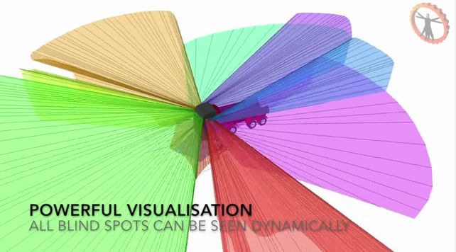

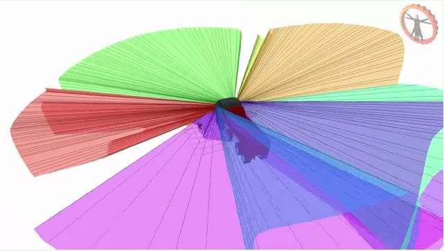

Nineteen different models of truck were examined in the study - from construction to long haul vehicles - and CAD designs of each were used to model the dangerous blind spots from each vehicle’s cab.
The researchers also examined reports of collisions,recreating the scenarios to see what the drivers could and could not see.
The team said that while all cab designs had flaws, the high cabs were by far the riskiest - and called for a new design standard to be set to minimise the dangers to other road users.
Project leader Steve Summerskill said: “We found that all standard vehicle configurations have blind spots which can hide vulnerable road users from the driver’s direct vision.
“However the height of the cab above the ground is the key vehicle factor which affects the size of direct vision and indirect vision blind spots. Low entry cab designs, which are the lowest of the 19 vehicles tested, demonstrated real benefits in terms of reducing direct vision blind spots when compared to standard vehicle designs.
“If you seriously want to reduce the number of collisions involving vulnerable road users and HGVs you have to improve the direct field of vision for drivers – and from our research this means lowering HGV cab designs or adopting low entry cab designs.”
